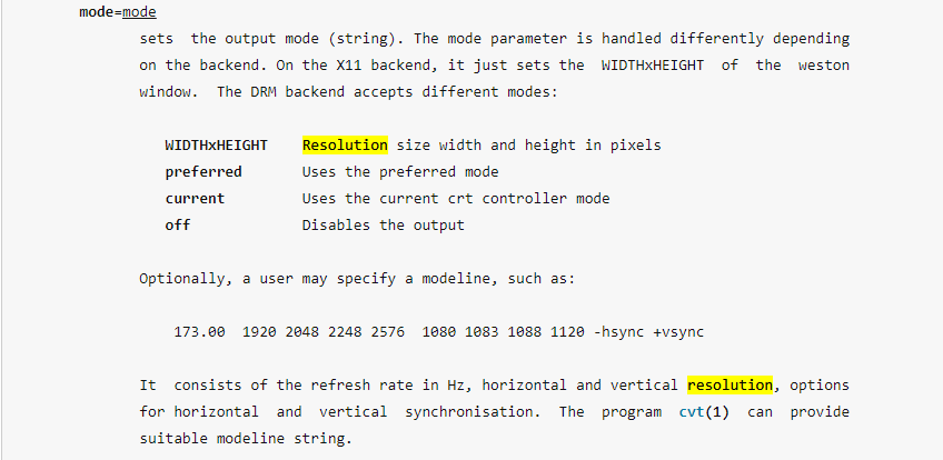

Hi all, I'm using STM32MP1 and stress it so to understand until the display resolution it can support.
I'm using a demo board and the demo SW installed.
How can I change the display resolution via shell?
Thanks

Hello @Ratataplam ,
You can find all the configurations possible for the Wayland Weston framework in the wiki: https://wiki.st.com/stm32mpu/wiki/Wayland_Weston_overview#Configuration
There is a link to the weston ini man page that explains the possibilities. The one that is interesting for you case is:
Regards,
Kevin
