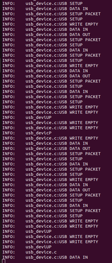

};I tried with/without the compatibility and the phy entries. Same result. On the console TF-A is waiting on something to happen over USB it seems. I've added prints to the USB area in TF-A and it repeatedly tries to get started but never does. Sometimes it'll show on the programmer side stage 2 indicating it's going to download the optee bin file but never gets started. Seems to have gotten a little more difficult to track down in source code what's happening so a bit of a challenge to debug.
