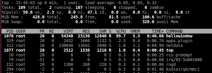

Hello Bernard, thanks for you answer.

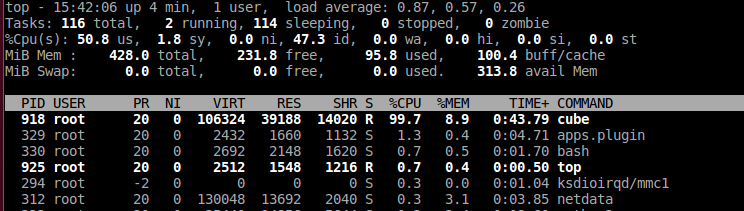

The hellowindow application looks well, but use the 100% of cpu.
The cube application move 1 frame each 3 seconds and use 100% of CPU.
We test the GTK environment and looks like use the gpu in correct way, but Qt looks like doesn't use it.

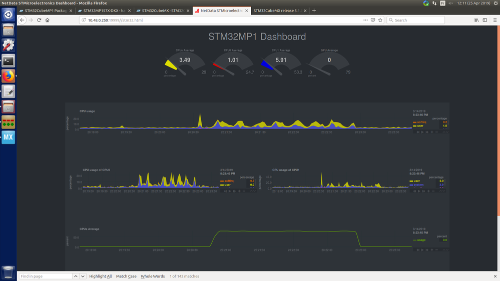

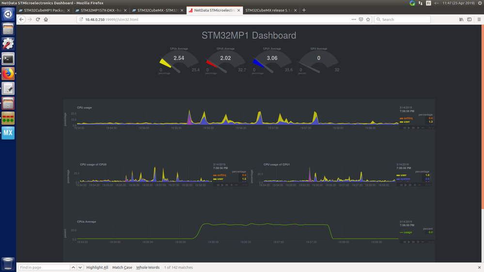

II/ You can also check GPU load with netdata: just browse on your host PC the following page: http://<your board ip @>:19999/stm32.html.
See https://wiki.st.com/stm32mpu/wiki/Netdata for more details.
On my side I have the following results:

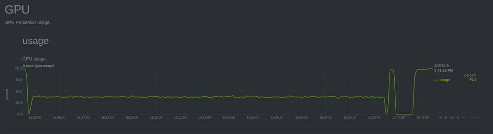

  • hellowindow (less than 10% cpu and 30% gpu):
  • cube (around 10% cpu and 80% gpu):
If you confirm the GPU issue, please check your build especially around the /vendor partition or during flashing (standard partition size need to be adapted for Qt image if you keep the webkit).

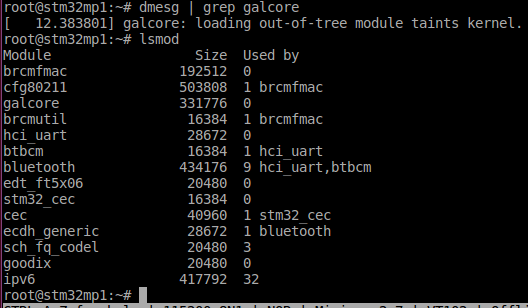

The module is not loaded, due that the st-example-image-qt doesn't generate the module.
The /lib in vendor folder doesn't exist.
I have make several test:
  • compile again the recipe st-example-image-qt without webkit and modifying the flashlayout in order to increase the space in sdcard partition, the installation finish without problems.
  • the  st-example-image-qt doesn't generate the galcore.ko module, is needed add the package "gcnano-driver-stm32mp" to st-example-image-qt.bb, then the galcore module appear in dmesg (is loaded by kernel)

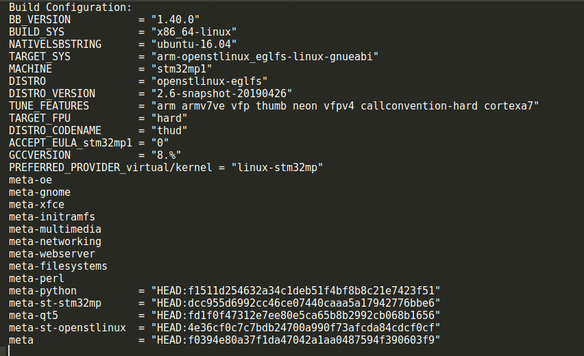

Build Configuration:
Galcore kernel module:
After these changes we have the same issue, the system doesn't use the GPU.
Can you share the recipe for "st-example-image-qt" that are you using? looks like is not the same

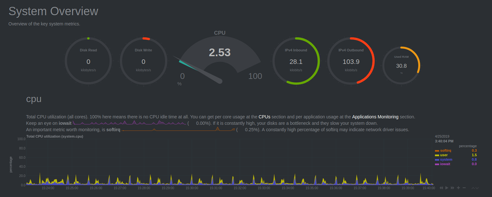

You are right, just adding the EULA agreement, the GPU works like expected. (ACCEPT_EULA_stm32mp1 = "1" at local.conf)
CPU use "cube application"
GPU use "cube application"
Thanks again for your help, we can continue testing the MPU features.
