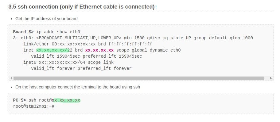

I've try to connect to the through SSH but it's seem no sshd is running :
BOARD $> ssh root@xx.xx.xx.xx
BOARD $> ssh: connect to host xx.xx.xx.xx port 22: Network is unreachableBOARD $> systemctl sshd -l
BOARD $> No ssh.service foundI would like to install openssh through apt but I can't found any package.
Indeed /ect/apt/sources.lsit.d is empty.
Currently How to manage the debian packages in OpenSTLinux distribution doesn't provide any information.
Can someone told me how install openssh with apt on the board ?
2019-10-03 3:21 PM
So I found the mistake, in the wiki the address used is the brd address instead the inet address.

Don't search for a sshd, you have "dropbear" installed as your ssh server. Do you find that:
root@stm32mp1:~# ps -ef | grep dropbear
root 710 1 1 18:17 ? 00:00:00 /usr/sbin/dropbear -i -r /etc/dropbear/dropbear_rsa_host_key -B
And with netstat you should find something listening on port 22
root@stm32mp1:~# netstat -tuln
Active Internet connections (only servers)
Proto Recv-Q Send-Q Local Address Foreign Address State
tcp 0 0 127.0.0.1:8125 0.0.0.0:* LISTEN
tcp 0 0 0.0.0.0:1534 0.0.0.0:* LISTEN
tcp 0 0 0.0.0.0:19999 0.0.0.0:* LISTEN
tcp 0 0 0.0.0.0:5355 0.0.0.0:* LISTEN
tcp 0 0 :::22 :::* LISTEN
2019-10-03 3:14 PM
Yes I see something listening on port 22 but when I try to connect to the board I get ssh: connect to host XX.XX.XX.XX port 22: Network is unreachable.
I'm sharing my wifi through rj45 maybe the problem is here ?
