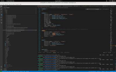

I carefully checked the dts and found the spi3 was not enabled.
But after I enabled the spi3(line 754), the spi bus can't be probed.
