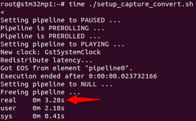

I calculated how much time spent for below script:

And the results are:
These results are too much for me. I saw that too much time spent especially on convert section.
I know that decreasing resolution might be one of the solutions, but is there any other suggestions to reduce that time?

Hi Erwan,
Yes I tried the JPEG, and the JPEG conversion is faster than PNG. I will also check other suggestions.
