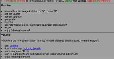

maybe you can use the alsa definition from rasperry... but almost sure, you have to adapt it -> edit /etc/modules/ and /etc/modprobe.d/
