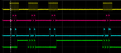

I'm working with the STM32MP131FAE in a bare-metal environment, and I'm experiencing issues with QuadSPI.
I want to use Quad SPI to send 96 bytes of data continuously without any clock interruptions.
However, currently, the data is being sent in chunks, with breaks every 4 bytes.
Is there a way to resolve this issue?
From top to bottom, the signals are CLK, Data1~3.
