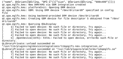

Currently I have been facing issues trying to display example QT applications on our display panel (which is proven to be working). Sorry if this should be in another post.
We can use a command like this to display an image:
gst-launch-1.0 filesrc location=/mnt/sda1/test-image.png ! pngdec ! videoconvert ! imagefreeze ! kmssink driver-name=stm
The application can be built and run on the host machine just fine. It cross-compiles without error for the target.
I have these variables set:
export QT_LOGGING_RULES=qt.qpa.egldeviceintegration=true
export QT_LOGGING_RULES=qt.qpa.eglfs.kms=true
export QT_DEBUG_PLUGINS=1
export EGL_LOG_LEVEL=debug
export MESA_DEBUG=1
export QT_QPA_EGLFS_DEBUG=1
export LIBGL_DEBUG=1
and my /usr/share/qt5/cursor.json file looks like this:
 "device": "/dev/dri/card0",
 "outputs": [
   { "name": "DPI-1", "mode": "800x480", "size": "800x480" }
 "hwcursor": false,
 "pbuffers": true
Log output returns this
