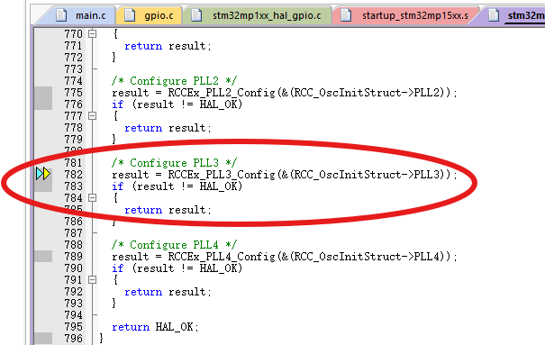

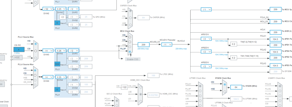

There is a problem about PLL3 while using engineering mode on STM32MP157A-DK1 board. By STM32CubeMX, I configed the clock of M4 core, using PLL3P to get 209MHz, generated code, rebuild it and entered the debug mode. But it shut down and get into an Error. I debuged it bt step, found that it failed in the intial function HAL_StatusTypeDef HAL_RCC_OscConfig(RCC_OscInitTypeDef *RCC_OscInitStruct). When it get to configure PLL3, failed and enter the error. So what I missed? May someone can help me. Thanks!

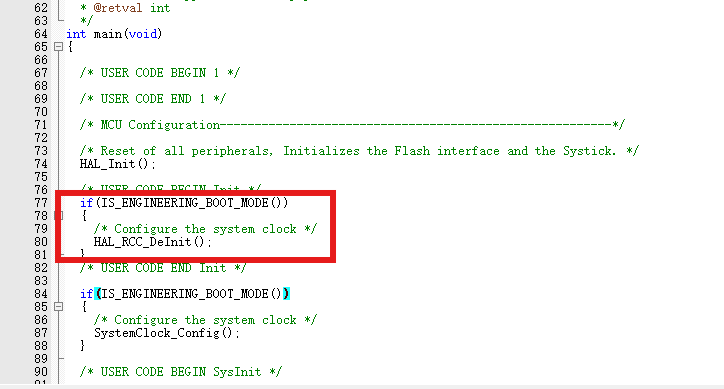

I found the reason. When using the stm32cubeMX, the generated code lost a rcc DeInit() function. In main.c, before SystemClock_Config(); Add HAL_RCC_DeInit(), and everything is good.
