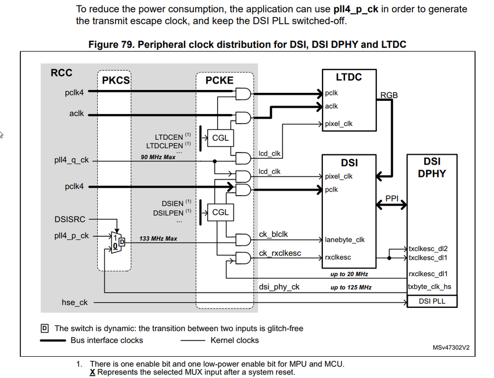

By looking at the refman RM0436.pdf v5.0 page 572:
0693W00000LyimIQAR.pngWe can see that the pclk is pclk4.
So I don't know why pclk4 is not available with your board.

In a working case you must have something like that on pclk4:
   pclk4                             1        1        0   133250000          0     0  50000
       ddrperfm                       0        0        0   133250000          0     0  50000
       stgenro                        0        0        0   133250000          0     0  50000
       usbphy                         0        0        0   133250000          0     0  50000
       iwdg2                          1        1        0   133250000          0     0  50000
       dsi                            0        0        0   133250000          0     0  50000
       ltdc                           0        0        0   133250000          0     0  50000
Please can you also get the tool devmem2 by following this page on the wiki: https://wiki.st.com/stm32mpu/wiki/How_to_read_or_write_peripheral_registers#Developer_Package
and read the value of te register RCC_MP_APB4ENSETR:
/usr/local/devmem2 0x50000200
The bit4 must be set to 1:
