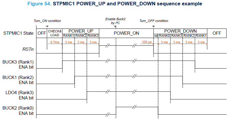

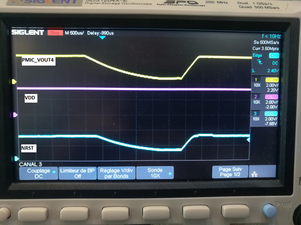

An oscilloscope plot of VDD/etc... supplies and NRST during power off might help you to understand if the system is not going to shutdown at all (i.e. NRST before the power off sequence is really asked to STPMIC1) or if a restart from shutdown occur due to wakeup request (PONKEY or WAKEUP STPMI1 pin).
If needed, see STPMIC1 datasheet for more details on turn_off sequences and options and turn_on conditions.

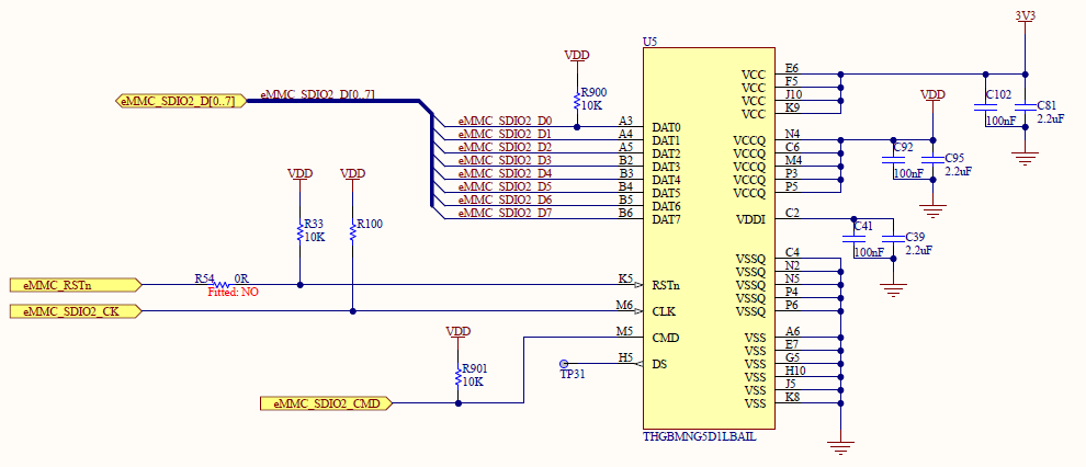

En effet, we use the nrst signal in order to reset emmc chip at the same time.
After removing the connection, i can poweroff my board, and wake it up by button.
Unfortunately emmc chip is powered by +3.3(PMIC_VOUT4), which is the one who get disabled, so nRST is going low because supply is going low (well nRST is an input for emmc, no reason to be drived! weird behavior).
Meanwhile, i've monitored (scoped) nRST,+3.3(PMIC_VOUT4) ,+3.3(VDD) from pmic, and i see that one
3.3(PMIC_VOUT4) is going down, and so nRST, so my chip will reset, and then reboot.(see pic)

I don't either see nRST moving. I don't see the cycling of power supplies combined with nRST, like the image you show me.

note that eMMC NRST is not always required (it is even not enabled by default in the eMMC), in particular with STPMIC1 where there is a power cycle when NRST is activated (so, eMMC will do a internal power-on reset).
If VCCQ is connected to STM32MP1 VDD (and VCC to +3V3) it would work without this NRST issue. See our STM32MP157F-EV1 board.
Some pull-up are required on data/CLK/CMD lines to avoid eMMC over-consumption in STANDBY (when +3V3 is shutdown but not VDD).
