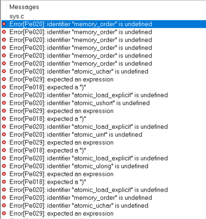

i am trying to compile the third party OpenAMP folder in IAR with C++ and am facing a lot of errors.
how can these be resolved.

I am facing a similar issue. If i keep my main file with .c extension it works, but except for the generated code, we have entire code base in cpp.
Can you please help

Thankyou for the reply. i am not using MP1 package but STM32H7 package for dual core microcontrollers. Yes i used the CubeMX to generate the code.
The problem arises because of using c++ instead of c. I guess OpenAMP doesnt support c++. Is there any help on this?
