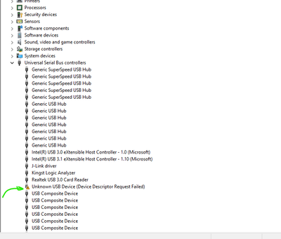

While running in it as it is out of the box, we have found out that on-board STLink-V2.1 doesn't work at all when connected to Win11.
We've installed latest STM32CubeProgrammer and it actually installed latest STLink USB drivers (VCP and STLink) but despite all our efforts STLink doesn't work (LD06 doesn't glow) and Win11 Device Manager flags it as under error:
Is there solution to this issue ?

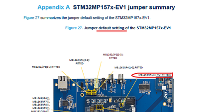

JP1 must be removed (otherwise it force the STLINK in reset in order to avoid conflict when using another debugger).
Probably a manufacturing issue when they setup default jumpers.

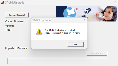

Could you try an STLINK FW upgrade https://www.st.com/en/development-tools/stsw-link007.html

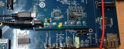

Hi @PatrickF
I've confirmed...
Here is photo of board. LD6 is not illuminating at all.
What would be next thing to try ?
