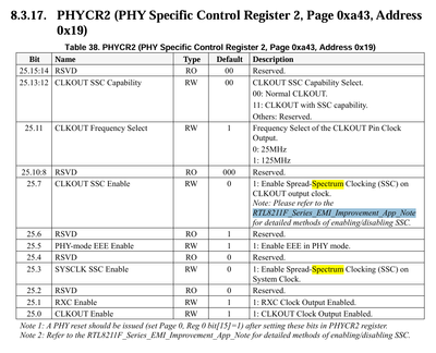

Has anyone found the Realtek document RTL8211F_Series_EMI_Improvement_App_Note this was written to explain the Spread spectrum operation. Below is a snippet from the RTL8211 datasheet
