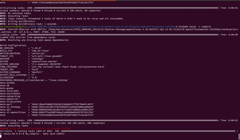

Creating openstlinux-5.10-dunfell-mp1-21-03-31 distribution installation,

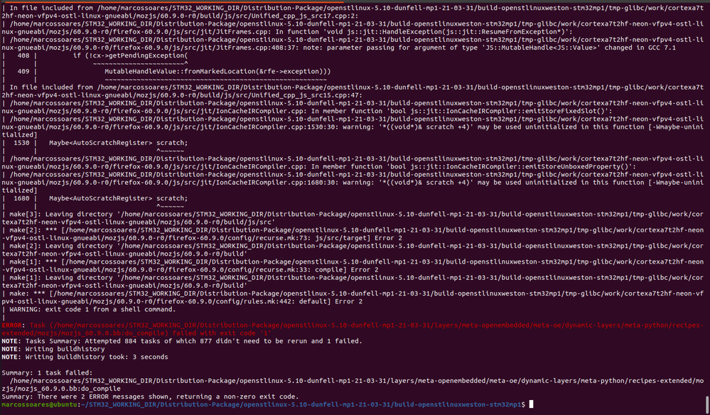

with bitbake st-image-weston, error rises:
(..layers/meta-openembedded/meta-oe/dynamic-layers/meta-python/recipes-extended/mozjs/mozjs_60.9.0.bb:do_compile) failed with exit code '1'
Tried:
bitbake -b mozjs -D -f
bitbake mozjs -c cleanall
bitbake mozjs -c compilebut the same error occurs.

EDIT (solved):
Changing the available RAM from 4.5GB to 6GB seems to solve the issue.

2022-01-26 2:47 AM
Increasing the available RAM to 8GB did not solve the issue for me. Looking at dmesg I still had "Out of memory" logs, which killed the bitbake process.
However, as a further step I had to increase the swap memory as well. This solved the issue.
2022-03-30 2:56 PM
I'd like to leave this here as reference.
I had a similar error when trying to build the st-image-weston.
After that I tried bitbake mozjs with a successful result. Provided that such a package is now compiled in the build directory, I was able to run again bitbake st-image-weston
The problem might still be memory and this answer just validates that (although I have 16GB...)
