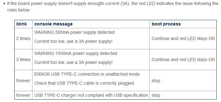

Note: if you power the board outside the Type-C connector, you will have a wrong detection of USB Type-C CC1/CC2 lines, and the board will probably stop the boot sequence.
You could probably fake that detection by providing relevant pull-up from 5V supply (see USB Type-C standard) or by modifying the SW.

My coworker provided 2 fip-*.bin that bypass the check for USB-C power so that STM32MP157F-DK2 can be powered from our custom connector board. So the answer is yes, the board was powered without USB-C he said. I'm not sure if the fip*.bin should be put into fip-a or fip-b partition, but will try fip-a soon. Any hints appreciated.
