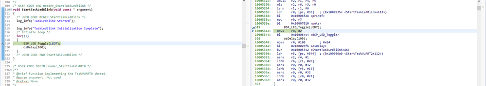

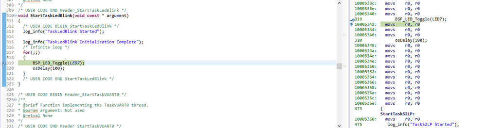

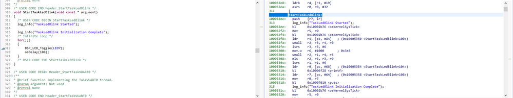

could you please precise if you are using SW4STM32 (i.e. GDB/OpenOCD debug) or another debugger ?
There is a separate thread which sound similar : https://community.st.com/s/question/0D50X0000B422in/stm32mp1-freertos-debug-issue

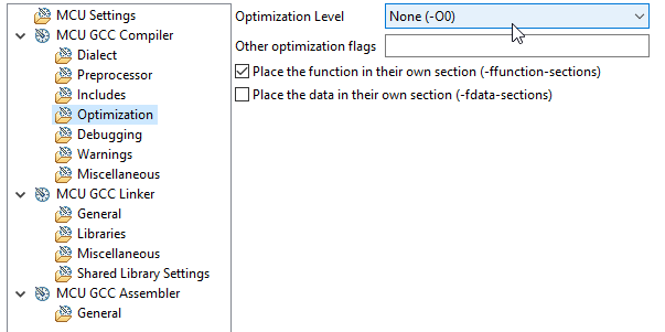

Is reducing the optimization level solve your issue ?
Seems linked to the way GDB manage the debug and the way FreeRTOS manage the stack pointers.

Here is some images showing what i am experiencing:
This image shows what i see when I initialize the mutex (but do not use it, as seen in the app_freertos.c file in the previous post) and i am stepping inside the function MX_FREERTOS_Init before the scheduler is called. We can see that i placed a break point inside the Led blink task and that the dissasembly seems ok for that part of the code:
Then, when i hit the "resume", it hits the breakpoint and the disassembly seems ok. But when i press resume again, it should hit back the same break point 100ms later...but it hangs there and its over.
The board is now bricked and has to be reset before i can launch a new debug session. Here in this last image, i launch the debug session with no breakpoint. The code is running fine (the led is blinking), but when i place a breakpoint at the same place, i get a weird disassembly. Also i cannot "resume" because it hangs there.
I tried declaring the mutex/semaphone, and delete them immediately after, and it does the same thing. The only wait to be able to debug with break points is to not initialize any semaphone or mutex.
I cannot continue my projet without mutex or semaphore...as i need task synchronisation.
Also i observed the same problem when using Queues. There are using semaphore under the hood and when ever i insert a breakpoint, it hangs.

2019-07-30 10:26 AM
Hi Patrick,
I am using SW4STM32 and it looks like it works when i remove the option "optimize for debugging" and set it to "None":
I will move foward and see if it still works when i start using the declared mutex and semaphore.
Thanks!
2019-07-30 2:13 PM
Ok so here is the sad part:
When i use "None" in Optimization level, OpenAMP works erratically and end up crashing!
But when i use "Optimize for Debug", everything works (OpenAmp, semaphores, mutexes, queues, etc.) but i cannot insert a breakpoint!
This is a major issue for debugging!
