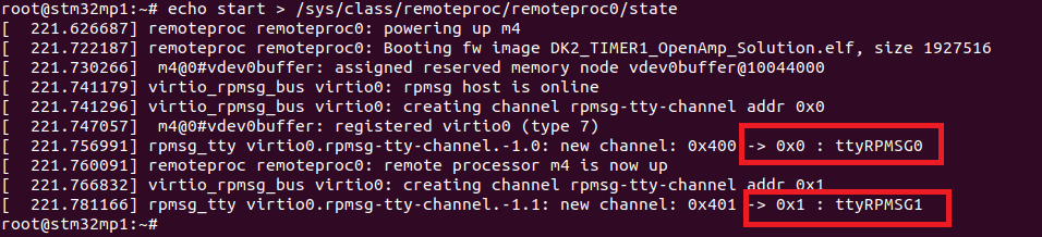

I am trying to replicate the workshop STM32MP1 - 11 Inter-Processor Communication Lab Example. I create a new STM32 project and copy all the data from the lab example. Then I connect the device (STM32MP157C-DK2) but the /dev/ttyRPMSG0 does not initialize (so I can´t send message between processors):

Hello @TArre.1,
Some questions to better understand your issue.
Which version of OpenSTLinux do you use ? 4.0 ?
In your example, does it mean that you cannot see ttyRPMSGX in "/dev/" folder from Linux side ?

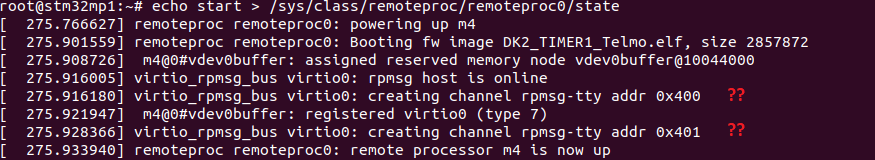

2022-10-26 3:21 AM
I am using OpenSTLinux 4.0.1 version.
Exactly. I initialize in main.c program (in STM32CubeIDE) the vitual uarts:

Then, I run .elf file on the STM32MP157C-DK2 board but in "/dev/" folder I cannot see ttyRPMSGX.

2022-10-26 6:12 AM
@TArre.1 ,
On a personal example of co-processor communication, I have exactly the same logs as yours so it seems that the initialization logs are normal.
Can you share me your main.c file (from M4 side) ? I would like to check if something is going wrong somewhere.

2022-10-26 6:32 AM
A simple test that you can do is to open your virt_uart.c file (Middlewares/Third_Party/OpenAMP/virtual_driver), and check that you have the following line at lines 48-49:
/* this string will be sent to remote processor */
#define RPMSG_SERVICE_NAME "rpmsg-tty"If you do not see it, for sure you do not have the right version of this file, and it causes the same trouble as you can see right now.

Hello @TArre.1,
How did you deploy your Linux side on the target ? Are you sure that your device tree is the MX generated one ? I ask you this because IPCC node activated in Linux (A7) device tree is mandatory to make the coprocessor work.
Did you follow this article with an MX machine creation ?
With activating the following dynamic printk, you can check if IPCC is functionnal + the different rpmsg:
echo -n 'file stm32-ipcc.c +p' > /sys/kernel/debug/dynamic_debug/control
echo -n 'file virtio_rpmsg_bus.c +p' > /sys/kernel/debug/dynamic_debug/control

2022-10-27 1:01 AM
Hi Erwan,
I just created a new project in the STM32CubeIDE and copied the main.c from the example in workshop 11. Then I tried to follow the steps in the slides to send messages between processors.
So, once the program is created, what are the steps to follow to send messages between processors?
Thanks!
2022-10-27 1:46 AM
Hello @TArre.1,
The different steps are explained in the following wiki article: https://wiki.st.com/stm32mpu/wiki/Getting_started/STM32MP1_boards/STM32MP157x-DK2/Develop_on_Arm%C2%AE_Cortex%C2%AE-M4/Modify,_rebuild_and_reload_a_firmware
Note that due to copro architecture, it is mandatory that the A7 cortex send the first message to initialize the communication. In the article example, this is made by the first "Hello Virtual UART0" message.
