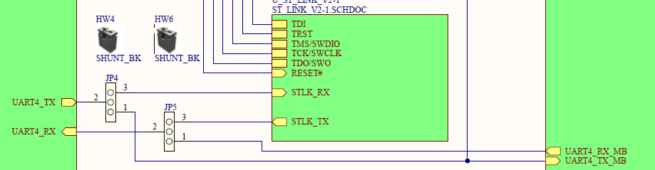

2022-10-12 5:45 AM
Did you set the JP4 and JP5 ?
Please refer to https://www.st.com/resource/en/user_manual/um2648-evaluation-boards-with-increasedfrequency-800-mhz-stm32mp157-mpus-stmicroelectronics.pdf

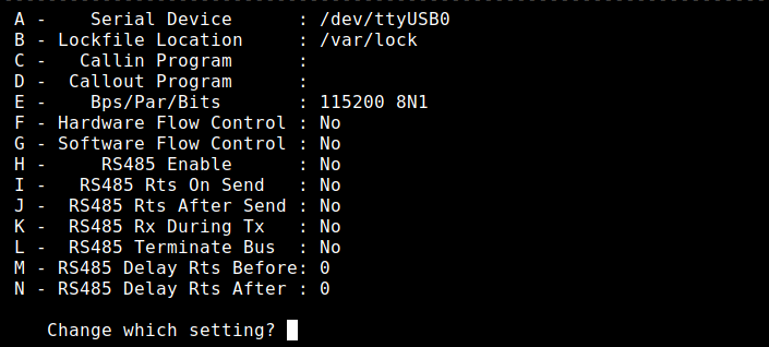

2022-10-13 5:22 AM
I have already tried switching to all baud rates of minicom. Here i am inserting the current setup (via UART). The par/bits were 8n1 by default.
I work exclusively from linux pc and I can also connect via ssh without a problem. Only ST-Link has an issue. I have also tried the USBs of other STM boards.

2023-01-20 8:24 AM
never hard of STLINK UART issue unless internal FW were corrupted by some misprogramming.
You might need to check signals presence on JP4 and JP5 (which are used to route UART4 to either Motherboard or STLINK)
You could even try to loop STLINK RX and TX on JP4/JP5 to tests or use an external UART<->USB transceiver on JP4/JP5 (or an STLINKV3-SET)
