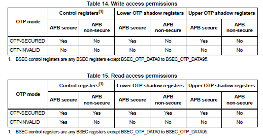

From user manual, from OTP word 59th for user to store sensitive information, meaning there is a way to prevent read them by STM32cube tool for non-secure application.
We see the way to lock them which mean can't not change values, any document that tell how to hide these registers from STM32cube tool for non-secure application.
2022-07-24 11:48 PM
I think there is nothing to do, read access from non-secure is always avoided in upper OTP.
Regard.

2022-07-24 11:48 PM
Regard.

2022-07-25 6:17 AM
That make sense to us,
Thank you so much!
