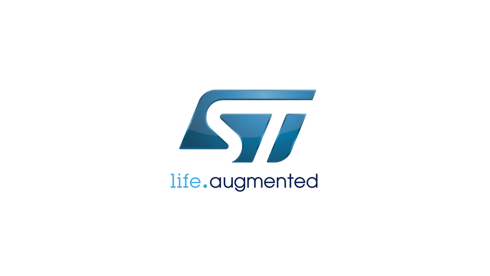

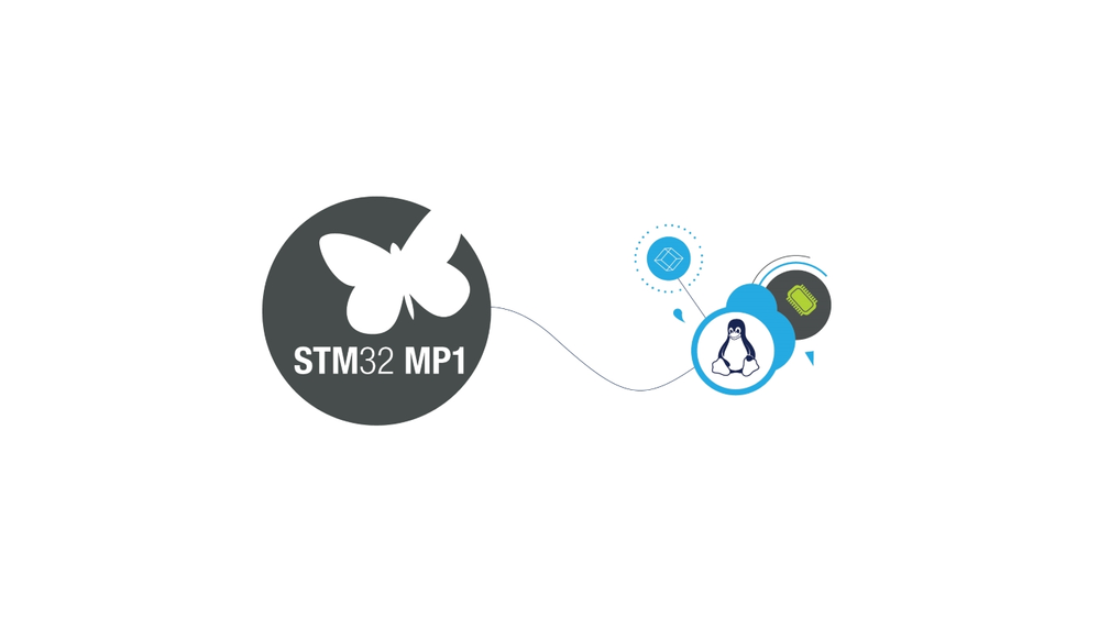

When boot with the weston service disabled
The two images below appear sequentially.
I want to customize the boot screen to the image I want.
I found the above images in the path below.
layers/meta-st/meta-st-openstlinux/recipes-graphics/wayland/weston-init/
Although I did find the path of the default boot images,
I think it has nothing to do with weston-init because the weston service is inactive.

first image is uBoot splash screen (splash.bin in bootfs I think)
second the Linux one
see section 7 in https://wiki.st.com/stm32mpu/wiki/Getting_started/STM32MP1_boards/STM32MP157x-DK2/Let%27s_start/Populate_the_target_and_boot_the_image
