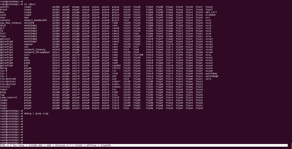

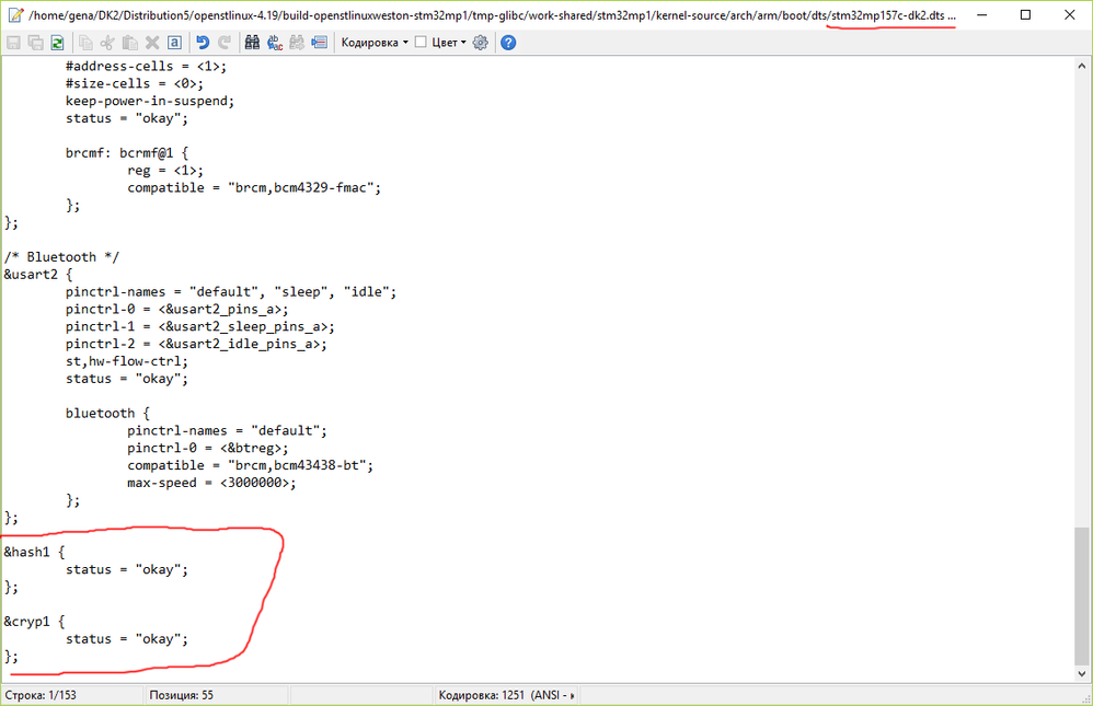

2019-05-13 3:53 AM
I have added these lines to the end of the file "stm32mp157c-dk2.dts":
Than I clean and build the image again
bitbake st-image-weston -c cleanall
bitbake st-image-westonAnd download basic image to the DK2 board using STM32CubeProg.
Unfortunately there are no any cryp devices in /dev/
What I am missing here?
