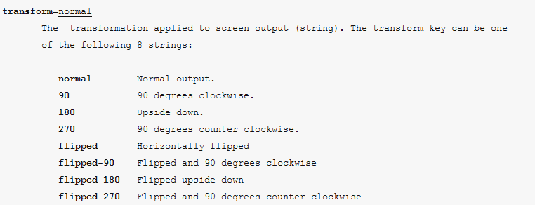

I'm making custom board with stm32mp157AAA.
lcd works nomally, but i want rotate this to 90.

Hello @DLee.15
I don't know if you are still trying to rotate your screen, but the section that must especially interest you in the link provided by @Community member is:
https://wiki.st.com/stm32mpu/wiki/Wayland_Weston_overview#Configuration

Hi @DLee.15 ,
If you are using weston wayland please have a look to :

Hello @DLee.15
