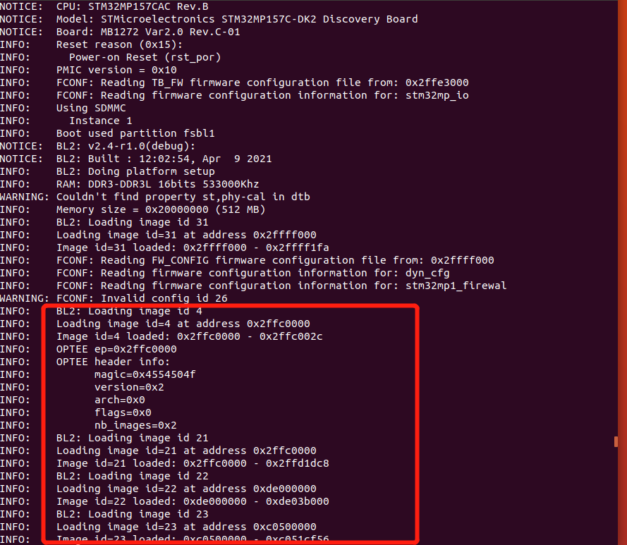

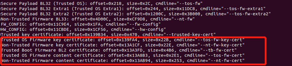

I used the latest official version(2021-03-31) to configure the stm32mp157c-dk2 of the optee version, and used the official tutorial to generate fip.bin and burn it to the corresponding partition, but it seems that the image is not checked,in other worlds, I did not see the successful prompt for the verification of the mirror image.

The only way can you can ensure that it works is that the complete firmware + certificate are loaded:
Image 31 (FW_CONFIG) required Image 6 (Trusted Boot Firmware Certificate).
You have mode loaded images (ID must correspond to all certificates) to confirm that it works.
There is no possibility to skip the authentication so if OP-TEE/U-Boot are launched, authentication is successful.

Yes, I configured it according to this (use the TF-A makefile), but I did not see the corresponding verification process when stm32 was started(the startup log did not seem to change). I want to know if I I have forgotten any steps,thanks

According to your traces, the FIP seems to be properly generated BUT the BL2 is not build with the TRUSTED_BOARD_BOOT=1 support. So the processing to load associated certificate chain is not supported in your current BL2 TF-A binary -> No authentication.
To ensure that it is properly on, there is a trace during boot to now if the crypto_lib is initialized:
NOTICE: BL2: v2.4-r1.0(debug):v2.4-stm32mp-r1
NOTICE: BL2: Built : 12:14:26, Apr 10 2021
INFO: Using crypto library 'stm32_crypto_lib'
Please rebuild the TF-A BL2 as explained https://wiki.st.com/stm32mpu/wiki/TF-A_BL2_overview#Trusted_boot_support and reflash it.

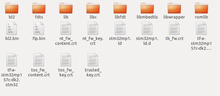

Hello, I have now modified the configuration of BL2 according to the document and the configuration command is as follows:
make ARM_ARCH_MAJOR=7 ARCH=aarch32 PLAT=stm32mp1 DTB_FILE_NAME=stm32mp157c-dk2.dtb STM32MP_SDMMC=1 STM32MP_EMMC=1 AARCH32_SP=optee TRUSTED_BOARD_BOOT=1 GENERATE_COT=1 DYN_DISABLE_AUTH=1 MBEDTLS_DIR=/home/tflgr/mbedtls
Then I configured the fip binary file again, the command is as follows:
make ARM_ARCH_MAJOR=7 ARCH=aarch32 PLAT=stm32mp1 AARCH32_SP=optee
BL33=../../FIP_artifacts/u-boot/u-boot-nodtb-stm32mp15.bin
BL33_CFG=../../FIP_artifacts/u-boot/u-boot-stm32mp157c-dk2-trusted.dtb
BL32=../../FIP_artifacts/optee/tee-header_v2-stm32mp157c-dk2.bin BL32_EXTRA1=../../FIP_artifacts/optee/tee-pager_v2-stm32mp157c-dk2.bin
BL32_EXTRA2=../../FIP_artifacts/optee/tee-pageable_v2-stm32mp157c-dk2.bin
FW_CONFIG=../../FIP_artifacts/arm-trusted-firmware/fwconfig/stm32mp157c-dk2-fw-config-optee.dtb
MBEDTLS_DIR=/home/tflgr/mbedtls TRUSTED_BOARD_BOOT=1 GENERATE_COT=1
ROT_KEY=./plat/arm/board/common/rotpk/arm_rotprivk_rsa.pem fip
The following files were generated, and then put .stm32 and fip.bin into the sdb1 and sdb3 partitions with the dd command.
But the startup log did not change and did not output INFO: Using crypto library 'stm32_crypto_lib', as follows:
NOTICE: CPU: STM32MP157CAC Rev.B
NOTICE: Model: STMicroelectronics STM32MP157C-DK2 Discovery Board
NOTICE: Board: MB1272 Var2.0 Rev.C-01
INFO: Reset reason (0x14):
INFO: Pad Reset from NRST
INFO: PMIC version = 0x10
INFO: FCONF: Reading TB_FW firmware configuration file from: 0x2ffe3000
INFO: FCONF: Reading firmware configuration information for: stm32mp_io
INFO: Using SDMMC
INFO: Instance 1
INFO: Boot used partition fsbl1
NOTICE: BL2: v2.4-r1.0(debug):v2.4-dirty
NOTICE: BL2: Built : 16:43:51, Nov 17 2020
INFO: BL2: Doing platform setup
INFO: RAM: DDR3-DDR3L 16bits 533000Khz
WARNING: Couldn't find property st,phy-cal in dtb
INFO: Memory size = 0x20000000 (512 MB)
INFO: BL2: Loading image id 31
INFO: Loading image id=31 at address 0x2ffff000
INFO: Image id=31 loaded: 0x2ffff000 - 0x2ffff1fa
INFO: FCONF: Reading FW_CONFIG firmware configuration file from: 0x2ffff000
INFO: FCONF: Reading firmware configuration information for: dyn_cfg
INFO: FCONF: Reading firmware configuration information for: stm32mp1_firewal
WARNING: FCONF: Invalid config id 26
INFO: BL2: Loading image id 4
INFO: Loading image id=4 at address 0x2ffc0000
INFO: Image id=4 loaded: 0x2ffc0000 - 0x2ffc002c
INFO: OPTEE ep=0x2ffc0000
INFO: OPTEE header info:
Thanks.

I found that the size of bl2.bin compiled from fip.bin is different from the size of bl2.bin produced by compiling bl2. If fip image is generated firstly and then compile bl2.bin , the following error will occur:
