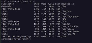

Please use df command to check mount successfully or not.
