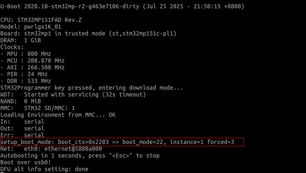

The force_mode of boot_ctx is always set to 3, which force the MPU to boot over USB, rather than MMC. I tried to set TAMP_BKP20R(BOOT MODE) to 0, but the behavior is the same after reset.

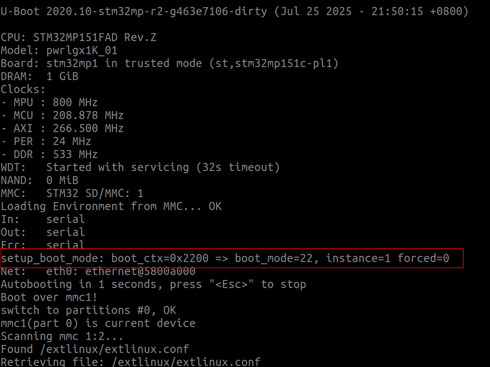

Aslo, I have another board (hardware is slightly different, but boot pin configuration is the same), which works well.
I know it can be fixed by changing UBOOT code. My questions are:
1. Is the value of this register boot_ctx set by ROM code?
2. The MPU model and version of the above two board are the same, STM32MP151FAD Rev.Z. Why is their behavoir different?

One assumption to check
May you properly delete the configuration of USER1 button in you DT ?
See description in LEDs and buttons on STM32 MPU boards - stm32mpu
Hope it help
Olivier
Olivier GALLIEN
Hello Olivier,
Thanks for your reply. USER1 button is already deleted in our curret DT. It still doesn't work.
Regards,
