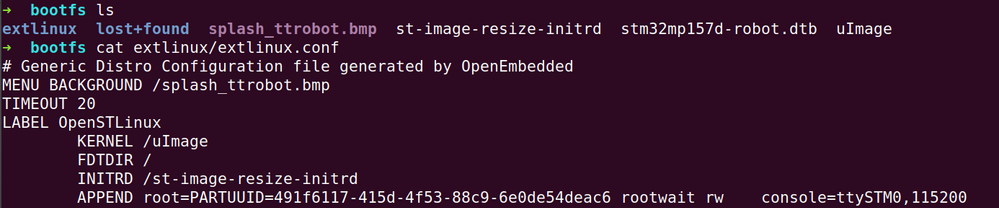

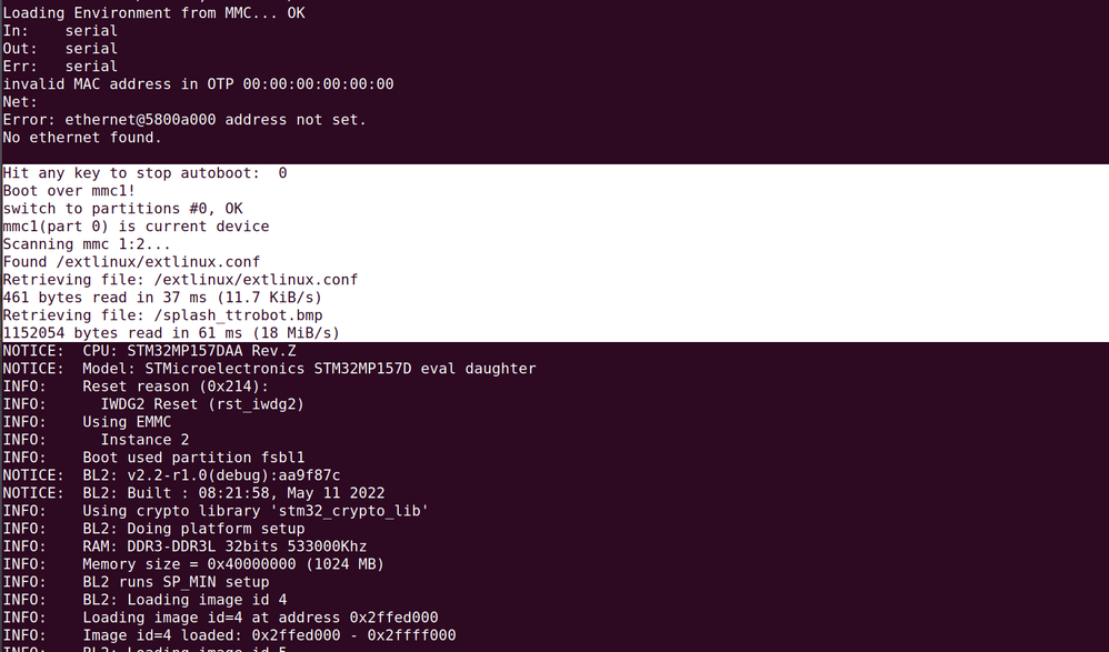

I am porting openstlinux for my robot board, I found that the system froze after uboot selected the extlinux file, and then rebooted after a while,the uart log :
0693W00000aIpSSQA0.pngDo I have any debugging means to analyze where the current problem is? thanks advance!
my extlinux.conf context:

its seens you are blocking when U-Boot try to display the splash screen
(it the last operation in the trace: extlinux is parsed, the bmp file is loaded and displayed)
and the Watchdog occur after 32s
it is the trace of 'Reset reason' in TF-A log = IWDG2 Reset

hi PatrickD:
After remove "MENU BACKGROUND /splash...." in the extlinux.conf  kernel boot success, i'll try debug the display issue, thanks a lot!
