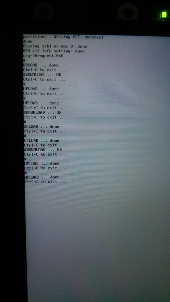

I attached an image of the output on the lcd display, and the complete CubeProgrammer log (verbosity level 2).
