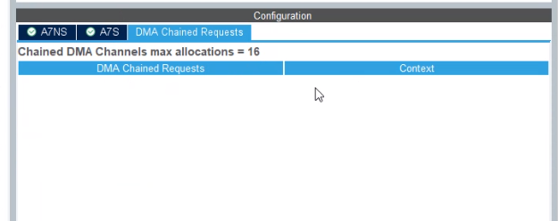

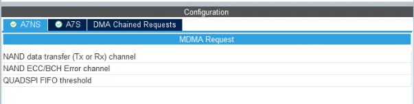

ok, we are using Linux with DMA but I am not sure, if we are using the "chained" mode in combination with MDMA. CubeMX looks like this.
