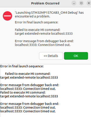

we're trying to debug an STM32 image (kernel-version V6.1.28) on the M4 core using STLINK-V3SET debugger via STM32CubeIDE (V1.16.0) and getting the following error:
Error in final launch sequence: Failed pre launch (s. attached screenshot).
The directory /lib/firmware has space and is writeable.
Does anyone have an idea what the problem is?

2024-10-24 5:47 AM
When I create this folder manually I get the new error: "Failed to execute MI command":

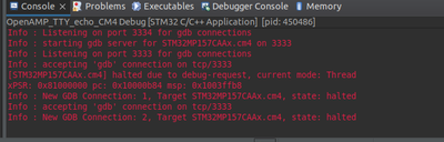

2024-10-29 9:11 AM
it seems that the openocd server cannot be started correctly. The console output shows:

2024-11-12 7:35 AM
Hello STea,
yes I know this Wiki of course and have the same settings. The only thing I changed was setting the interface from SWD to JTAG, because my baseboard provides only a parallel JTAG connector.
Obviously, you changed the debug probe field from OpenOCD to GDB server. Doing that here, I get the following log file attached (st-link_gdbserver_log.txt)
On my Linux debug console, I can see the firmware booting:
root@qsmp-1570:/home# [ 2156.292441] remoteproc remoteproc0: powering up m4
[ 2156.302348] remoteproc remoteproc0: Booting fw image OpenAMP_TTY_echo_CM4.elf, size 2687680
[ 2156.310558] rproc-virtio rproc-virtio.1.auto: assigned reserved memory node vdev0buffer@10042000
[ 2156.320231] virtio_rpmsg_bus virtio0: rpmsg host is online
[ 2156.325501] rproc-virtio rproc-virtio.1.auto: registered virtio0 (type 7)
[ 2156.332357] remoteproc remoteproc0: remote processor m4 is now up
[ 2156.338129] virtio_rpmsg_bus virtio0: creating channel rpmsg-tty addr 0x400
[ 2156.349738] virtio_rpmsg_bus virtio0: creating channel rpmsg-tty addr 0x401
also /dev/ttyRPMSG0/1 will be established.
in the Reset behaviour field of the debugger settings I have choosen None.
Is this correct? I wonder that the M4 firmware is obviously started, I would have expected that this is done by the debugger?
