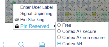

For pure GPIOs (i.e. not assigned to a functional IP), you should assign to Cortex-M4 using right-click:
