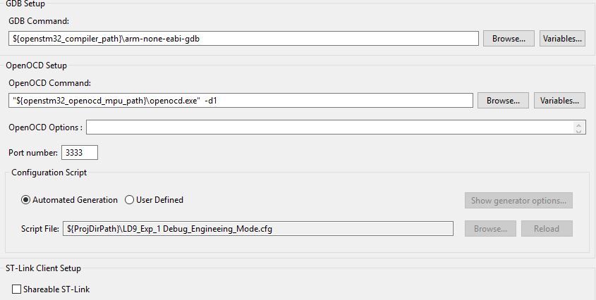

​Hi Antonio.
I am using the IDE using the default settings.
The Script File does inevitably load the …_dk2.cfg file.
I want to test using the command line.  How do I do this? With the "Command Shell Console" using local settings?
BMcCa.3
Associate II
