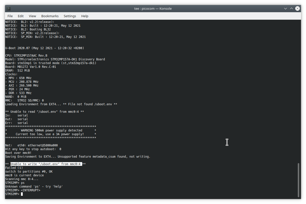

2021-05-20 8:17 AM
Hello !
I'm trying to boot an STM32MP157a-dk1 using an image that i made with build-root but when i boot i got this message :
Unable to write "/uboot.env" from mmc0:4
2021-05-23 11:50 PM
About the message related to power supply, uBoot is reading the level present on USB Type-C CC1/CC2 lines and check if supply is signaling it self as a 5V/3A (as per USB Type-C standard). There is plenty of charger which are not compliant to the standard (see TA0357 page 8), but if your supply is stated as above 3A, you could ignore the message (could be also removed in uBoot code if you wish).
Btw, with your uBoot version (2018.11), it seems that you are using Ecosystem v1.x, I encourage you to move to latest ecosystem v3.x (https://wiki.st.com/stm32mpu/wiki/Main_Page).
Regards.
2021-10-20 7:52 AM
Hello!
change buildroot/configs/stm32mp157a_dk1_defconfig file
BR2_TARGET_ROOTFS_EXT2_MKFS_OPTIONS="-O ^metadata_csum"
