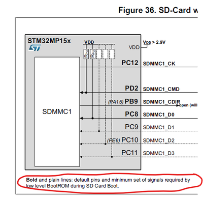

we use STM32MP1 SoC in some of our projects. Normally, we use eMMC card, so we use just two DIP switch positions: 000 (for uploading images into eMMC) and 010 (for booting from eMMC). We utilize SD card after booting from eMMC for storing our data.
Once I prepared bootable SD card and tried booting from SD using DIP switch 101 position. And nothing happened.
As long as we setup pins for SD card (in CubeMX, for example) and build images, Linux, U-boot and DTB become updated, so LInux and U-boot know, what actual pinout of SD card is. I wonder, at the first boot stage while BootROM selects media to proceed booting: eMMC, SD, USB (according to DIP switch position) how does it know actual SD (or eMMC) card pinout ?
I miss something important, please, guide me.

hi @mishuk ,
please refer to AN5031 (for STM32MP15) and https://wiki.st.com/stm32mpu/wiki/STM32_MPU_ROM_code_overview#Boot_from_SD_card
And if you don't want to Flashload your SD-Card on target using CubeProgrammer, see: https://wiki.st.com/stm32mpu/wiki/How_to_populate_the_SD_card_with_dd_command

2025-05-30 3:41 AM
Hi, Patrick
thank you for your reply. Now I know, that I should update OTP for setting actual pin layout for booting from SD card. That`s fine.

Next question: according to STM OTP mapping, OTP words 5-7 stand for non default AFmux. I suggest, that using these 3 words I can describe up to 6 pins, that is enough for SD 4-bit wide bus. I wonder, what is the order for pin description: does word5[15:0] refer to SDMMC_CK or SDMMC_CMD or any of SDMMC_Dx ?
2025-05-30 9:31 AM
I confirm, no possible to boot from SDMMC3.
for OTP AFMUX remapping, you just need to define the 3 pins used by the BootROM, i.e. CLK/CMD/D0 as stated in AN5031 and wiki (CDIR is optional and depend on your level translator if any).
As it is quite tricky, I think you could find some working OTP example of SD-Card remapping on SDMMC2 in this forum.
The whole SD-Card pins are defined in DT for later usage by TF-A/uBoot/Linux, and could use 4 bits modes and higher speeds.
