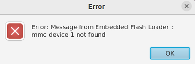

2025-03-25 8:55 AM
Hi @GatienC apologies couldn't reply earlier. I was doing a bit of experiemnts with the sdmmc nodes I have. It would be deemed as my lack of understanding about the terminologies used in the uboot for the sdmmc. So trying to enable sdmmc2 was a failed attempt at that. Basically at the moment I facing the issue, while trying to download the code it fails with the following error:
When I look into the log it shows the below:
mmc_init: -110, time 24
Error: mmc device 1 not foundIf I drop at the uboot prompt, and do a mmc rescan it finds the mmc1. So I tried implementing a rescan mechanims in the uboot code. If I do that it detects the mmc1 and the above error goes away but then it cannot fetch the erase block size for some reason and it fails again. Thta's why I was trying to check if SDMMC2 node has to be enabled in my project speciifc dts file and if that helps. But that didn't help. Sorry bit vague in my description but I am not entirely sure why it fails to detect mmc1. I have also tried changing the HW and it doesn't look like a HW issue. I think there maybe something wrong in my dts file and hence the error. Many thanks, Vivek
