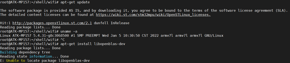

You have to keep in mind that you are using an image generated with yocto. As explained in another topic by a community member: https://community.st.com/s/question/0D53W00000G0wfFSAR/i-am-having-issues-in-stlinux-getting-aptget-to-find-any-packages
You can only install the packages that you have built with bitbake. So when a package is missing in the image, it might be easier to include those in the image recipe.
For most of the packages, they are already included in OpenSTLinux or can be retrieve thanks to the layer "meta-st-pkgrepo-updates" handled by ST. We are trying to add package in it regularly.
You can find more information on this layer on the wiki and then by going on the github link: https://wiki.st.com/stm32mpu/wiki/Package_repository_for_OpenSTLinux_distribution#Organization
For your specific package "libopenblas-dev", this package is not included in OpenSTLinux nor in the layer "meta-st-pkgrepo-updates" for the moment.

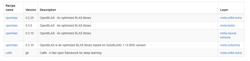

By doing a search on "https://layers.openembedded.org/", you can find several layers that contains the recipe that you are looking for:
You must add the layer that fills your need into yocto. I made some test on my Distribution Package and the one compatible with Kirkstone is "meta-neural-network". Kirkstone is the latest version of Yocto used to build OpenSTLinux in the latest Ecosystem release of ST.
