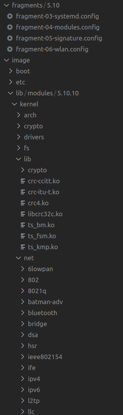

Looking at the build folder for linux-stm32mp looks like this:
I can find all the modules and drivers that I wish to load.

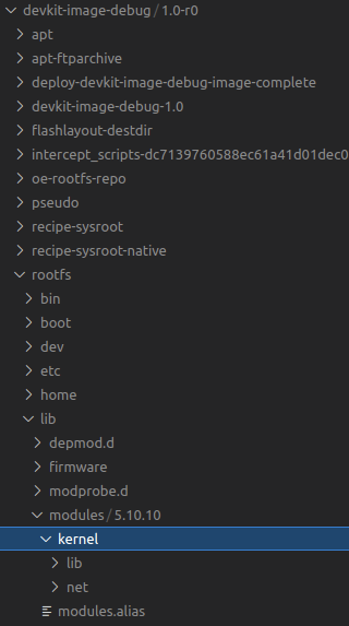

If I inspect the build folder for my output rootfs, I get this:
Clearly the end result does not includes the modules and drivers I was hoping to see there. Of course flashing the image leads to the same result, thus modules cannot be loaded.

Solved.
My image was ovewritting IMAGE_INSTALL and leaving out packagegroup-base-extended \
