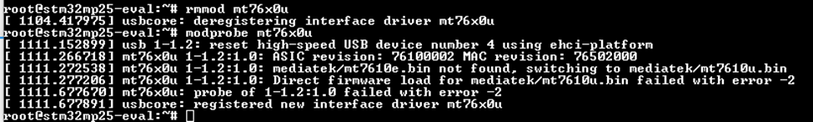

I updated the kernel image on board. However, when I plug in the dongle I get the error:

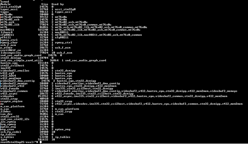

It looks like all necessary modules are present:
I tried to restart the module, same result:
I checked, this Wi-Fi dongle works with Ubuntu 22.04 and Raspbian.
Please, advise, what I’m doing wrong.

Hi @GLut_
altough quite old and related to another MPU, this post could help.
https://community.st.com/t5/stm32-mpus/how-to-use-edimax-ew-7811un-v2-wifi-dongle-on-stm32mp157a-dk1/ta-p/49790
Maybe you simply miss to get the relevant xxxx.bin in right location
Regards.

Thank you, @PatrickF for your reply.
Indeed, I'm missing mt7610e.bin and mt7610u.bin, but where do I get them? I've followed the instructions in example of Modifying kernel configuration in How to cross-compile with the Distribution Package, and as a result I got a new kernel image and relevant library files. No xxxxxx.bin files were created (or I couldn't find them), and nothing was mentioned about xxxx.bin files. How to get these files short of copying them from another system?
Actually, I created folder /lib/firmware/mediatek and copied mt7610e.bin and mt7610u.bin from RaspberryPi I have. After that I was able to load the driver and bring-up WiFi interface. It worked, but it does not feel like a proper way to do.
