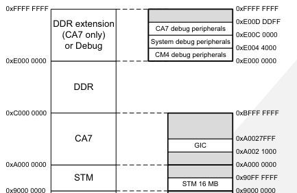

The memory 0xdf800000 is inside the DDR memory

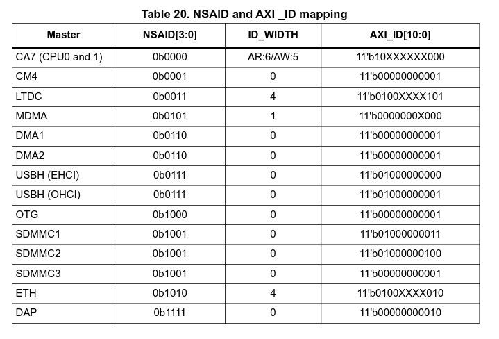

When I'm looking inside the datasheet and converting 0x4a0 and 0x480 to binary. Which becomes:
0x4a00x480
1001010000010010000000
So I guess it has to do with the CPU?
