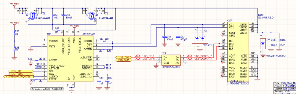

I have custom stm32mp1 board and when running it as USB mass storage in U-Boot (ums 0 mmc 0), the USB driver is not detected nor by Linux nor by Windows. I am also attaching shematc comparison of eval-board VS my custom board. Also the USB-ORG is working in Engineering mode as DFU device - so I am guessing the soldering and USB pinouts are correct.
Pic.1. Custom board schematics of USB-OTG

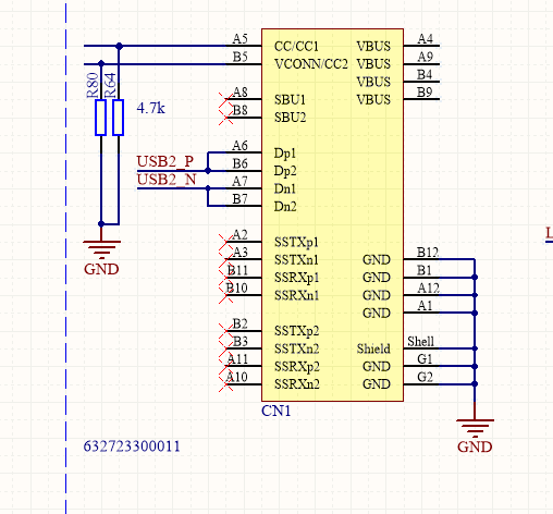

2.Pic. Eval-board schematic of USB-OTG.

};Btw, the pull-down Rd resistor on CC lines should be 5.1k (but I think 4.7k might not explain why PC did not detect your device as 10% tolerance is allowed)
