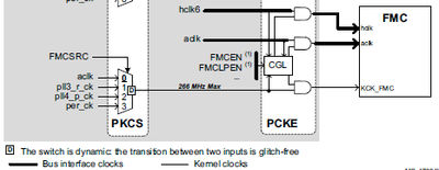

See also clocking, if not used by any driver, Linux will not enable the IP clock.
https://wiki.st.com/stm32mpu/wiki/STM32MP15_clock_tree#Device_tree_2
Try also
cat /sys/kernel/debug/clk/clk_summary
Notice that FMC has multiple clocks (bus clock and a kernel clock). I think all should be enabled to access registers.
