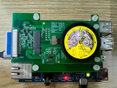

I'd like to build a bare metal ARM cortex-A7 driver for my MIPI DSI display module. Because there is no HAL driver for LTDC and DSI host then I decided to build it from scratch. I followed the procedures from the STM32MP RM document to configure the parameters and initialize the HW. However, I couldn't read the display ID from DCS read command, checking bit 4 PRDFE (in register DSI_GPSR) is always 1. I tried to configure u-boot to support my display module, compiled the u-boot then I could execute DCS commands without any problem. It took a few weeks to compare my driver implementation line by line with the u-boot driver, even dumping out all the register values. Finally, I noticed there is a different register setting in the u-boot driver:

After setting bit 28, my driver works well. Now I'm working on LVGL graphic library, however, its performance is not really good, FPS is about 7 frame/s. Is there any bare-metal GPU implementation for STM32MP1? Just tried to refer to the GPU spec in the RM but there is not much description in there.
