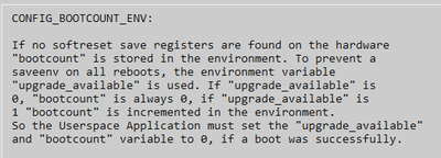

Setting CONFIG_BOOTCOUNT_ENV=y and CONFIG_BOOTCOUNT_LIMIT=y in the u-boot configuration before building fixes the problem. It also seems like upgrade_available is only used when CONFIG_BOOTCOUNT_ENV is set.
