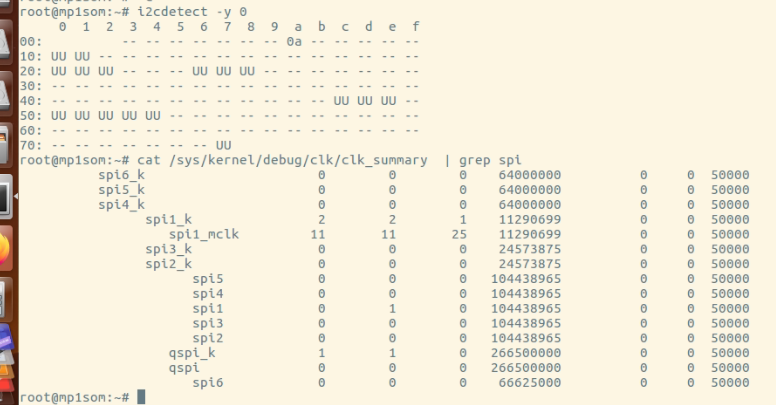

sgtl5000,c change as "mclk", still i didnt get mclk during probe of SGTL, but i see mclk is getting after 35 sec, where the root login prompt comes, which
you can see sgtl5000 lies at 0x0a, but probe still fails which means that i2s block is not providing the mclk during sgtl5000 probe,
if you have demo probe may you confirm the behaviour, but i see in scope after 35sec gets mclk enabled, following is the log

the above does not come during sgtl probe,
if you have demo board may you confirm the behavior ?
