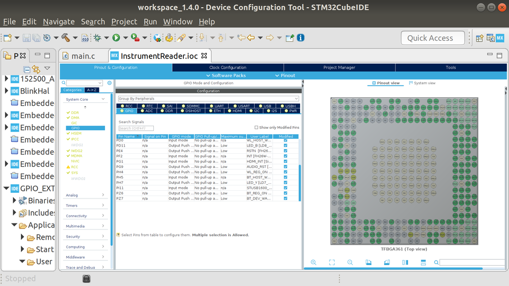

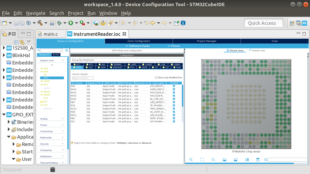

@KnarfB Thanks for the quick reply! I was trying to use the .ioc file to configure the GPIO pins that I wanted but the pin list was very limited. I included screen shots of the GPIOs that were listed. Then I looked at the GPIO example for the M4 projects and was planning on using the GPIO initialization function from that. The issue is where the example uses the USER_BUTTON_PIN for the interrupt configuration, I want to use different pins. Looking at the auto generated files in my project, I do not see pin definitions for Arduino pins or anything and cannot find anywhere online that states configuration details (like pin and port numbers) for those GPIO so that I could add them manually.

Lets say you find in the user manual Arduino connector that you want use pin PE10 as interrupt input. Enter PE10 in the search box bottom right of your screen shot, the matching pin(s) start blinking. Click on that pin and select GPIO_EXTI10 mode. Then, there appears a new entry in the GPIO list left. Select it to see or change the details. Now, if you right-click on that pin, you may give it a user name like "BLAST". Click also Pin Reserved and select Cortex-M4.
The user name appears as user label in the list and is used to generate two macros for your code:
(mian.h):
#define BLAST_Pin GPIO_PIN_10
#define BLAST_GPIO_Port GPIOENote that you could have directly used the generic names GPIOE and GPIO_PIN_10, but the user label assignment helps keeping track of all the pins and their modes.
Note also, that you can reconfigure already reserved pins. Then, you should check in the user manual and the schematics about the consequences.
