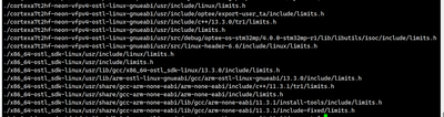

So do you actually have a limits.h file in your filesystem?
If you do, is it in a place where your compiler is looking? ie, somewhere covered by your Include Paths ?

Not necessarily missing: As I said earlier, it could be present but not in a place where the compiler is looking.
In fact, I think this is the more common case?
