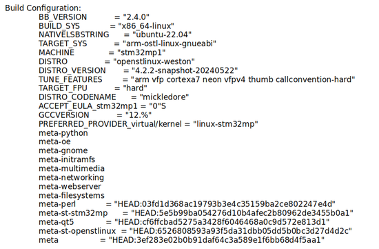

Build Configuration:
BB_VERSION = "2.4.0"
BUILD_SYS = "x86_64-linux"
NATIVELSBSTRING = "ubuntu-22.04"
TARGET_SYS = "arm-ostl-linux-gnueabi"
MACHINE = "stm32mp1"
DISTRO = "openstlinux-weston"
DISTRO_VERSION = "4.2.2-snapshot-20240522"
TUNE_FEATURES = "arm vfp cortexa7 neon vfpv4 thumb callconvention-hard"
TARGET_FPU = "hard"
DISTRO_CODENAME = "mickledore"
ACCEPT_EULA_stm32mp1 = "0"S
GCCVERSION = "12.%"
PREFERRED_PROVIDER_virtual/kernel = "linux-stm32mp"
meta-python
meta-oe
meta-gnome
meta-initramfs
meta-multimedia
meta-networking
meta-webserver
meta-filesystems
meta-perl = "HEAD:03fd1d368ac19793b3e4c35159ba2ce802247e4d"
meta-st-stm32mp = "HEAD:5e5b99ba054276d10b4afec2b80962de3455b0a1"
meta-qt5 = "HEAD:cf6ffcbad5275a3428f6046468a0c9d572e813d1"
meta-st-openstlinux = "HEAD:6526808593a93f5da31dbb05dd5b0bc3d27d4d2c"
meta = "HEAD:3ef283e02b0b91daf64c3a589e1f6bb68d4f5aa1"
I have tried many times to build the image, but I can't. I get some errors while building (generated log file, see attached file):
ERROR: rust-native-1.68.2-r0 do_install: ExecutionError('/home/alazaj/STM32MPU_workspace/STM32MP1-Ecosystem-v5.0.0/Distribution-Package/build-openstlinuxweston-stm32mp1/tmp-glibc/work/x86_64-linux/rust-
native/1.68.2-r0/temp/run.do_install.2586093', 1, None, None)
ERROR: Logfile of failure stored in: /home/alazaj/STM32MPU_workspace/STM32MP1-Ecosystem-v5.0.0/Distribution-Package/build-openstlinuxweston-stm32mp1/tmp-glibc/work/x86_64-linux/rust-native/1.68.2-r0/
temp/log.do_install.2586093
ERROR: Task (virtual:native:/home/alazaj/STM32MPU_workspace/STM32MP1-Ecosystem-v5.0.0/Distribution-Package/layers/openembedded-core/meta/recipes-devtools/rust/rust_1.68.2.bb:do_install) failed with exit
code '1'
Summary: 1 task failed:
Summary: There was 1 ERROR message, returning a non-zero exit code.
I've tried various ways, with and without accepting the EULA, but I couldn't get rid of this issue. Is this a known issue?

2024-05-24 3:08 AM - edited 2024-05-24 7:11 AM
After looking at the log file again, I was finally able to see the reason why rust-native failed.
warning: gcc: fatal error: cannot execute 'cc1plus': execvp: No such file or directory
warning: compilation terminated.
It would be better if thouse lines started with an error.
Anyway, I had several gcc compilers installed on my system. I simply removed some of them and ran
bitbake -c cleanall rust-native
bitbake rust-native
After that I was able to get rid of the errors. I will now build the st-example-image-qtwayland image and see if I can run the PyQt5 application.
