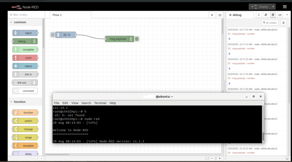

Here is my share of an unpretentious guide that allowed me to install nodejs and node-red locally on an STM32MP157C-DK2.
Hope this can help.
First of all, my config: SD card 16Gb with latest ecosystem release v2.0.0
  • Connect with ssh root and make apt cache up to date.
root@stm32mp1:~# apt-get update
  • Install nodejs and check version
root@stm32mp1:~# apt-get install nodejs
root@stm32mp1:~# node -v
  • Install nodejs npm dependencies
root@stm32mp1:~# apt-get install nodejs-npm
  • Install node-red
root@stm32mp1:~# npm install -g -unsafe-perm node-red
  • Start node-red
root@stm32mp1:~# node-red
  • After Starting flow success, open web browser and connect to node-red server using the ip adress of the STM32MP1 board on port 1880 (in my case http://192.168.1.33:1880)
Thank to apt support on new ecosystem release v2.0.0
