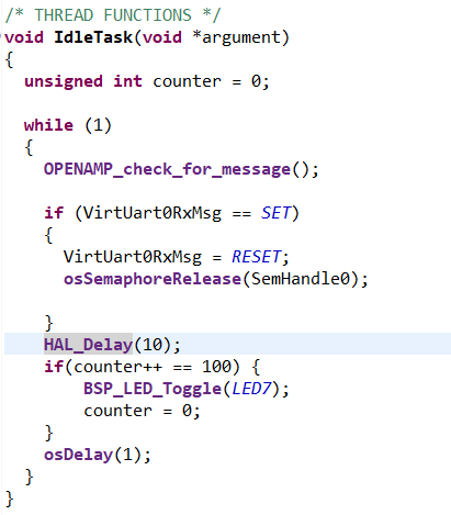

I'm not using debug mode. I'm running the firmware with echo start > /sys/class/remoteproc/remoteproc0/state. Here is my flow:
  1. Build the binary (HAL_NVIC_EnableIRQ(TIM2_IRQn) is added after HAL_Init)
  2. Transfer binary using SCP client (WinSCP)
  3. Copy binary to /lib/firmware
  4. echo OpenAMP_FreeRTOS_echo.elf > /sys/class/remoteproc/remoteproc0/firmware
  5. echo start > /sys/class/remoteproc/remoteproc0/state
  6. echo stop > /sys/class/remoteproc/remoteproc0/state

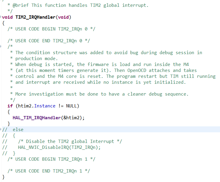

Do the 5. and 6. several times and the diode stop toggling. Code is OpenAMP_FreeRTOS_echo with added HAL_Delay(10) before if where diode is toggled (picture). Another question is how your TIM2_IRQHandler looks? Mine is on picture below.0693W000007DH94QAG.png0693W000007DH7hQAG.png
Hi @Community member​ ,
When I posted the above question I realized that I didn't tried combination to uncomment else which is doing HAL_NVIC_DisableIRQ in HAL_TIM2_IRQHandler above, with your suggestion to add HAL_NVIC_EnableIRQ after HAL_Init. It is working now! I tried 20 times maybe and diode is toggling every time (meaning HAL_Delay is not like while(1), and HAL tick is incrementing) when I stop and start firmware. Thank you!
Best regards,
Nenad
I think that I find out what is happening here... We are doing HAL_Init, and there HAL_InitTick is called, first HAL_NVIC_EnableIRQ is done, and several lines after htim2.Instance is set to TIM2. There's a problem, because interrupts are enabled, HAL_TIM2_IRQHandler is called and there:
 if (htim2.Instance != NULL)
  HAL_TIM_IRQHandler(&htim2);
 else
  /* Disable the TIM2 global Interrupt */
  HAL_NVIC_DisableIRQ(TIM2_IRQn);
So we will enter into else and TIM2_IRQn will be disabled because htim2 instance is not set. Because that if you add HAL_NVIC_EnableIRQ is working the job when placed after HAL_Init. So what is maybe better solution?
